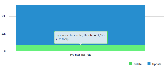

Hello, see script below:
var gr = new GlideRecord('sys_group_has_role');
gr.addEncodedQuery('group.type=d66994f011646000071e389470fb2e25'); // Runs on all Support Type Groups
gr.query();
while(gr.next()){
gr.role = '802d29e6db3f7300ee6d59b2ca961963';   //Pass the sys_id of ITIL
gr.update();
When I ran the script, it also DELETED 3,422 records on the sys_user_has_role table, do you know why that is?
You need to insert records and not update them.
follow what Linda Suggested.
