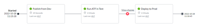

So that did fix it but then I noticed 2 Changes being created so I moved the step creating a change into the deploy job and now I get this error
Error: Internal server error. An unexpected error occurred while processing the request.
Attached the entire pipeline.yml file, not sure what the issue is
