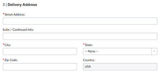

Hello all,
Yesterday, I spent more time than I probably should have trying to configure a single variable set for an address layout. My goal was:
- Two full-width lines (100%) for Address Line 1 (mandatory) and Address Line 2 (optional)
- Followed by four half-width lines (50%) for City, State, ZIP, and Country.
I’ve attached a photo for reference, but note that the pictured group was created using two separate variable sets.

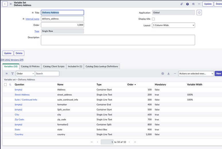

11-08-2025 05:34 PM
Hi Cristina,
You can accomplish this using two containers within one variable set - no macros, specific release, or overthinking needed.
11-08-2025 11:25 PM

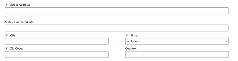

Hi @CristinaI370576 ,
I tried your problem in my PDI and it works for me please check below solution
I created a variable set type of "Single Row Variable Set"
We have to create variable with layout - single column wide, and in address 1 and address 2 give column width as 100% , and try to use Container Start, Container Split and Container End when you want to give two variable in 1 column for example city, state, zip and country.
Result:
Please mark my answer correct and helpful if this works for you
Thanks and Regards,
Sarthak

11-10-2025 04:56 AM
Actually, the solutions are different. @Brad Bowman you started yours with a start container. Kilo's did not. I have tried your solution in my instance and I am not sure if it's due to a rule set they have enabled but I don't get this result. I appreciate you both. I will retry and upload screenshots when I do. Thank you both!
