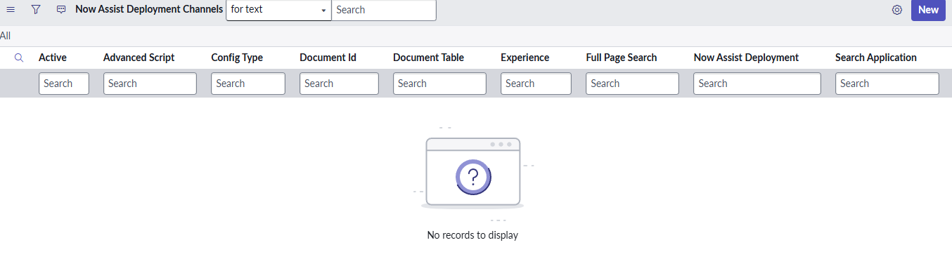

As there is an active deployment channel associated with ESC Portal [https://<instance-name>..service-now.com/sys_now_assist_deployment_channel.do?sys_id=4da54ec6879f2610185742ed0ebb3508], it is fetching the search application config for NASS enabled portal. In this case, it is "Now Assist in VA" so it is using the filters associated with this search application.
Tried de-activating the deployment channel [https://<instance-name>..service-now.com/sys_now_assist_deployment_channel.do?sys_id=4da54ec6879f2610185742ed0ebb3508] and then performed a search. The tabs were consistent with the ones configured on ESC Search application. Please find attached the screenshot for the same
