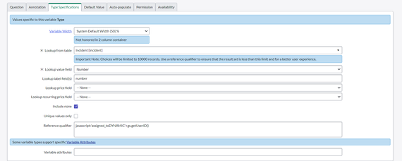

Hi guys, I am stuck in an issue. I have a catalog variable and it is referenced to a column of a table. The variable will display values that are assigned to me ( requester only). I have used the lookup select box and reference qualifier but it filters all values now. How can I custom the condition?

I want to display the serial number for the catalog item variable with the condition is displaying the serial number that are assigned to me ( the requester)

Hi @LinhN,
As I tried on incident table it worked.
You may try with following configuration.
Please mark my response as correct and helpful if it helped solved your question.
Rohit Suryawanshi
08-05-2024 07:23 PM
Hi, Thank you. I don't understand why it worked when I removed the '' apostrophes from the syntax, it worked. Do you know the reason of this?
