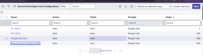

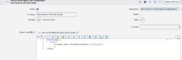

1. Check Configuration
Ensure that the "Now Assist in VA Chat Config" is active under your Service Portal Agent Chat Configurations
