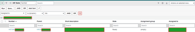

Screenshot below are the records that I need to display on the HR Case table.

1. You create a list of the HR Cases with the following filter and add the "parent" field:
The downside here is, that you won't see all of the "HR Cases fields", but only the Number. You can do the same within the HR Agent Workspace, but there you would only be able to add the "default parent" (task table) fields, and not the HR Case fields

But you can show HR Case on HR Task list by applying this condition
Have report on HR Task table and type as List and apply condition
Assigned to Me and then show HR Case (Parent) in the list
