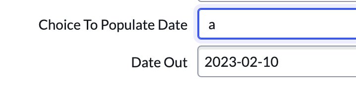

I will attach the results in the attachment. hope you were looking for this solution.
Mark helpful and accept the solution if it helps in solving your query.
