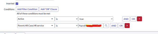

04-29-2025 03:40 AM - edited 04-29-2025 03:40 AM
However, it is not functioning as expected.
I attempted to create a notification at least without specifying a particular HR service, but that approach also failed.
I set the condition to "Active is true" and "Assignment group is empty" for the new HR task created notification. Despite this, the notification is still not being triggered. I believe I am overlooking something, but I am unsure what it might be.
04-29-2025 03:48 AM
share the notification config screenshots
Email is sent to which user i.e. recipient
Is that user active, not locked out and has email field populated in user record and has notification preference enabled?
