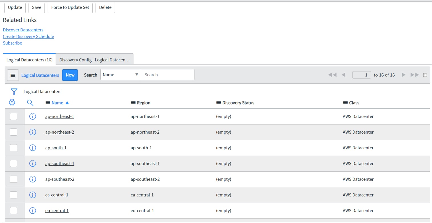

02-27-2022 10:36 PM
02-27-2022 11:47 PM
Yes, I see 17 datacenters
