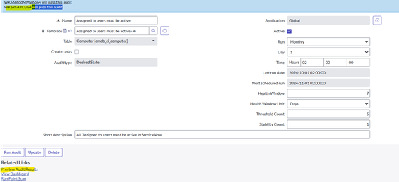

1 and 2 did not satisfy, in certification audit i don't see any state  field and in sys trigger table i opened the specific audit record and checked in that the next run is showing on feb 1st 2026 (future ) as it is monthly run.
for 3rd point yes "Run As" field of audit record is showing as an inactive user in prod but in dev also that's the case but it worked there when i click on run audit. by changing run as to system admin and then manually running it will work?
4th point, in certification audit i have a related link "preview audit results" when i click that it show some annotations like "XXX will pass this audit" but in audit result it is empty.
Audit record:
i get this error but not sure because of this Invalid query string received:null: java.lang.NullPointerException:
and source is com.glide.ui.ServletErrorListener

Even if it worked in DEV with an inactive user, Production environments often have stricter security constraints or different system property settings regarding impersonation. * The Fix: Change the Run As field on the Certification Audit record to an Active Admin user (or yourself for testing).
2. The NullPointerException (Point #4)
The error java.lang.NullPointerException in the ServletErrorListener usually triggers when a script expects an object or a value that isn't there. In this context, it is likely trying to pull a user profile or a system property that is missing in PROD but existed in DEV.

  3. Check for "Certification Instances": After you click "Run Audit" manually, look at the Certification Instances related list at the bottom of the Audit record.
    • If a new Instance is created but has 0 tasks, the issue is the Filter.
    • If no Instance is created at all, the Audit Script/Job is crashing (which explains the NullPointerException).
