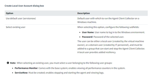

Hi Gilberto,
ServiceNow Document doesn't have the exact configuration, below is what is provided by ServiceNow regarding the user:
You can use the OOTB user creation while installing the agent and then check the configuration of that user create and follow it for a domain user so that it can be applied to all the agents and you end up with a single global user.

‎12-20-2023 12:40 PM
@pratik0306 : I would recommend assigning either Local SYSTEM, Local Service or a gMSA account. Avoid the servicenow user account, since user accounts aren't normally designed to run Windows Services. If you go with gMSA, you normally need "Logon As a Service" and "Debug Programs" privileges. "Debug Programs" is to retrieve the full path of running processes along with their parameters. You can find more information in the KB1122613 in the webinars, as well as some command line samples in the git repository.
