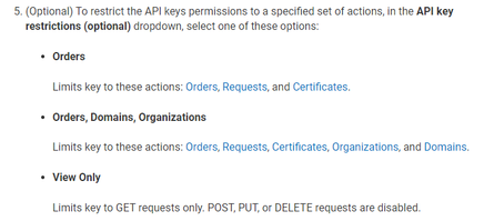

When I tried to debug it looks like I am not able to make a query to   "/services/v2/order/certificate" As a result it's returning empty results and failing
Does anyone experience a similar issue? is this happening because of a restriction to the API key? Currently, its view only ie only get request is allowed.  requesting some help.

Based on the information provided, it is possible that the restriction on your API key is causing this problem. If your current API key allows only "GET" requests, it may explain why you are unable to make the necessary query to retrieve the certificate information.
To resolve this, you need to ensure that your API key has the necessary permissions to perform the required operations. Specifically, you should check if your API key has the appropriate permissions to make "POST" requests to the "/services/v2/order/certificate" endpoint.
Please make sure that your API key has the necessary permissions to create or update certificates, as well as retrieve their information. You may need to consult with your system administrator or the relevant team responsible for managing API keys and access permissions.

As per Digicert docs below are the restrictions possible :
So I am a bit confused here because the docs are not clear about having API restrictions. what do you recommend?

We originally tried setting our API key restriction to view only which resulted in the same "Certificate List is Empty" error. We also tried setting the API restrictions to Orders, Domains, and Organizations but keep getting an empty certificate list error.
