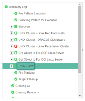

The one highlighted is the extension I've added,
