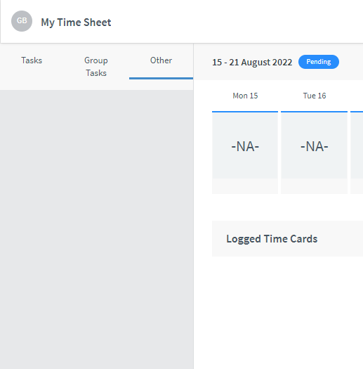

Could anyone assist from where we can customize or add the options under "Other" tab on time sheet portal.
Please see attached screenshot.

It is added as a choice on time_card.category.
