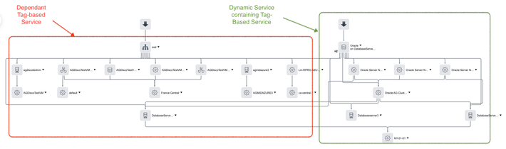

Hello, hopefully my input is not much overdued. I have recently done a similar exercise with my customer and suggested to combine Cloud (Cloud Discovery) and On-Prem CIs (scheduled imports sets) using the "dependant Service" feature. This implies creation of the "main" Service of the Calculated/Dynamic class, where CIs are added based on the imported CI Relationships, and "dependant" Tag-Based Service, where CIs are discovered. The steps, I followed:
- Create tag-based service instance for resources in cloud
- Create Dynamic Service Instance with the Depends On::Used By relation to all on-prem service components and Tag-based Service
- Configure system property sa.service.population.stop_expansion_under_ci_classes=EMPTY
- Resulting Service Map (Dynamic one) will show combined on-prem and tagged service elements
Thing to consider: the Tag-based service part will not look same as a standalone Tag-Based Service, because of the Dynamic service populator impact. Because of this, more CIs can appear, which might be excessive, e.g. Availability Zones.
Let me know, if the solution was helpful and/or any gaps noticed, we could work to address. Thanks!
