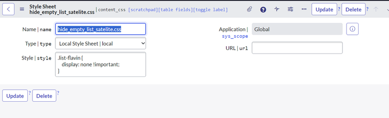

The stylesheet is stored in the content_css table. This is what the CSS looks like:

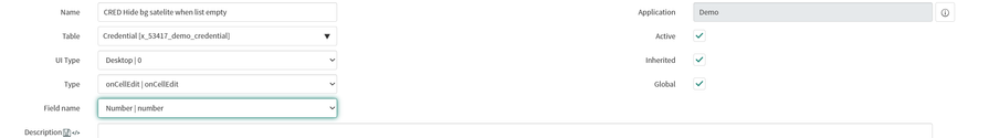

There's not much to the CSS. I'm just hiding that div that contains the satellite image. To inject that stylesheet into the page I create a onCellEdit client script that looks like the following:
* I am executing this function outside of the onCellEdit call because
* I want to always execute this function on the list view. I'm only
* using the onCellEdit as a mechanism to execute this code when the
* list is displayed The code is adding a stylesheet that hides the
* satelite background image when the list is empty. ServiceNow
* provides no way to do this. So I am manually hiding it by injecting
* some CSS into the page. I need to do it this way because
* lists are displayed on both dashboards and in normal list views.
* There really is no good mechanism to get arbitrary JavaScript to
* run on a responsive dashboard, so I'm using the onCellEdit to run
* this code every time the list is displayed
(function() {
if (!top.gsft_main) return;
// Injects a stylesheet into the page that will hide the
// satelite image for an empty list
// getting a reference to document. ServiceNow blocks
// this reference so I am going around to get the reference myself
var document = top.gsft_main.document;
// The sys_id is the sys_id of the stylesheet in content_css
if (!document.getElementById('a1fcb8399745711024d7b066f053af11')) {
var link = document.createElement('link');
link.id = 'a1fcb8399745711024d7b066f053af11';
link.type = "text/css";
// hide_empty_list_satelite.css
link.href = '/a1fcb8399745711024d7b066f053af11.cssdbx';
link.rel = "stylesheet";
document.head.appendChild(link);
// This is unused intentionally
function onCellEdit(sysIDs, table, oldValues, newValue, callback) {}
As you can see. That's rough just to hide an image, and it's not global. It's attached to a specific table also, so to get this to work you'd need to run it on every table you don't want to display the satelite image.
