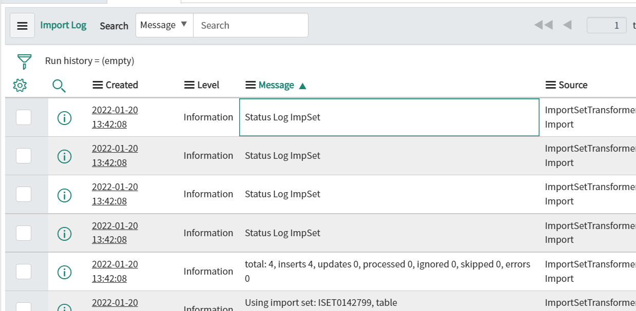

I am using onBefore transform script to implement IRE using below code to identify and ignore duplicate CI.
(function runTransformScript(source, map, log, target ) {
log.info("Status Log ImpSet");
var cmdbUtilIRE = new global.CMDBTransformUtil();
cmdbUtilIRE.setDataSource('ImportSet');
cmdbUtilIRE.identifyAndReconcileEnhanced(source, map, log);
ignore = true;
if (cmdbUtilIRE.hasError()) {
var errorMessage = cmdbUtilIRE.getError();
log.info('Error: ' + errorMessage);
log.error(errorMessage);
} else {
log.info('IE Output Payload: ' + cmdbUtilIRE.getOutputPayload());
log.info('Imported CI: ' + cmdbUtilIRE.getOutputRecordSysId());
})(source, map, log, target);
When I run the transform I do not see any logs from CMDBTransformUtil , below is the import set logs
What would be the possible cause can someone please put some light into this to resolve it.?

I expect some kind of exception might be occuring to cause the code to exit. Suggest you wrap the whole thing in a try - catch block and see if you get more detail?
try{
ignore = true;
} else {
} catch (err){
log.error("Caught Error\n" + err);

I see an "Catch Error :TypeError: undefined is not a function." after apply try n catch.
Creating CMDBTransformUtil itself is giving the error.
Is this the correct way to call ?
