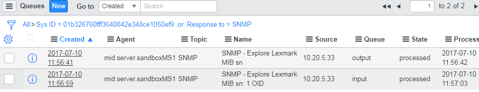

Thank you to both David, Ravindra (response here) and Doug Schulze (great SNMP Classifier YouTube), I am posting some details I used to resolve because "sharing is caring" and I hope it will help others.
1. Go to OIDVIEW to download MIB's for LEXMARK-PVT-MIB
2. Remove extension from file
3. Load MIB into ServiceNow using-> MID Server > SNMP MIBs
3.a. attach file
4. Re-Start MID Server(s) while watching the ECC Queue for errors (there were no errors)
5. Create new exploration probe using -> Discovery Definition > Probes
6. I created a user field for the serial number without a dash.
7. Create a new sensor for this new probe (named SNMP - Explore Lexmark MIB sn) using -> Discovery Definition > Sensors.
(Note: I do not have the script populating the field and I am having our developer Kaushik help me with the script. Still tweaking, but all this is finding the data when I Test Probe )
8. Modify CI Classifier using -> Discovery Definition > CI Classification> SNMP
8.a. select --existing--> Standard Network Printer
8.b. (tab) Triggers probe ... (button) Edit ... select probe from slush bucket
8.c. add a conditional script for Lexmark only (values.get("sysdescr").indexOf('Lexmark') > -1)
9. Return to CI Classifier
10. Test Probe finds the data
Thank you ServiceNow Community for all the help! Barb
