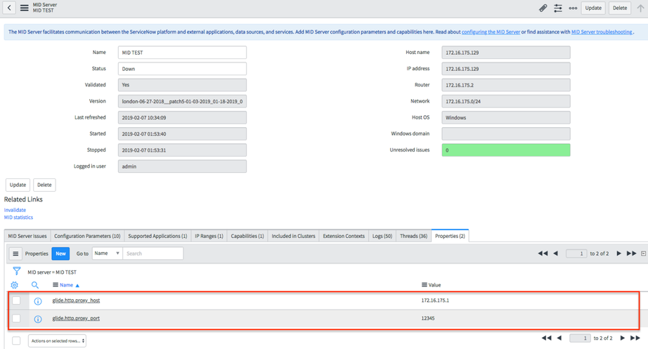

So I added a proxy in the properties of MID Server
glide.http.proxy_host
glide.http.proxy_port
But after adding it, the URL of the REST API cannot be accessed
