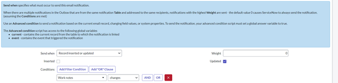

In catalog item there is a variable set and the variable named notify (list collector) and refer to user table.... once the request is submitted with the user details in the notify field and when work notes/comments in catalog task are updated then notification needs to be sent to the users present in the notify variable.

If  you want to add list of users in TO address then use event triggered notification as you can't directly dot walk from notification.
If  you want to add list of users in CC/BCC address then use event triggered notification as you can't directly dot walk from notification.
- Create a notification on Task table

Hi @suuriya ,
This is possible to achieve. Please register a new event using the Event Registry module. Trigger this event when your trigger condition is met, i.e. on catalog task update/ on req_item update. Create a notification and configure it to run when event is fired. Pass the targeted audience details via event parms to Notification.
E.g. Trigger event using the following code:
gs.eventQueue('event_name', current, parm1, parm2);
use either parm1/parm2 to pass recipient details, set parm1 = notify_variable, and leave parm2 as empty string, i.e. ''.
On the Notification record, check  'Event parm 1 contains recipient'.
