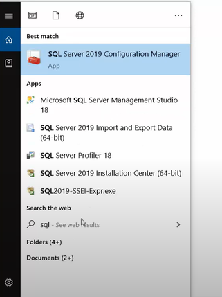

Hi @pratiksha5

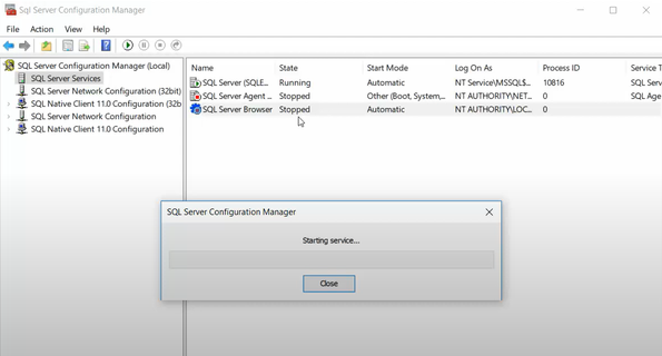

1. In the windows host where your database installed, goto the SQL server configuration manager
2. Start the sql server browser if its not running

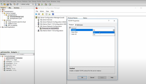

3. Now goto SQL server network configuration -> protocols for sqlexpress.
4. Enable the TCP/IP
5. In IP addresses section of TCP/IP properties , add the TCP port as 1433 if not added under IPALL section

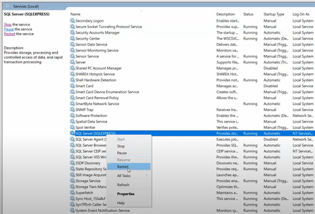

6. Restart the sql server from windows services
Now try again .
