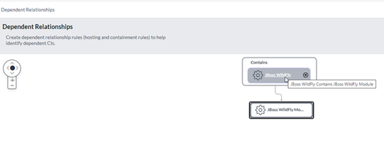

For anyone doing the training and running into the same issue. Double check the Dependent relationship you created for the JBoss WildFly Module CI, it needs to be "Contained By [...]" and not "Contains [...]". If its set to "Contains" then you will run into the error the original post mentioned.
06-27-2024 02:28 PM - edited 01-30-2025 03:07 PM
Thank you! This resolved the issue for me.
Go to CI Class Manager > Application Server > JBoss WildFly Module > Dependent Relationships
Depending on the perspective, ensure Jboss Wildfly contains Jboss Wildfly Module or Jboss Wildfly Module is contained by Jboss Wildfly.

Could I please get some help also, my relationship is as shows above and double checked on the metadata editor, any help would be amazing!
