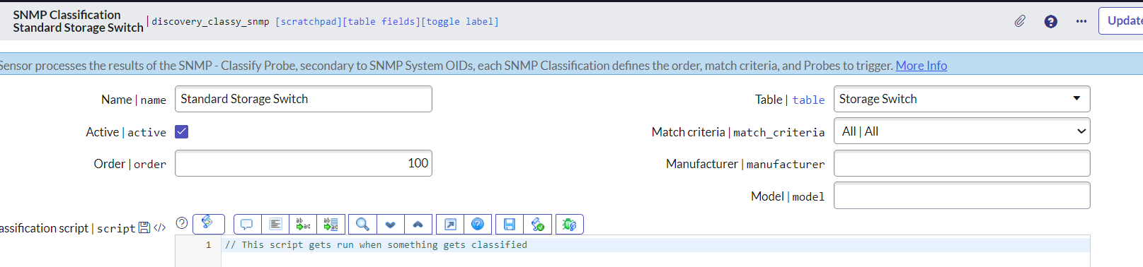

1.3.6.1.4.1.1588.2.1.1.118 is an SNMP OID which is classified as IP switch (oob) brocade manufacturer. when discovery checks the OID Ci is getting identified and created/ updated in IP switch class.
Requirement: -

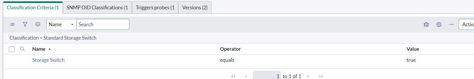

i want this to be identified as "storage switch" so i have created an SNMP classifier as storage switch and renamed 1.3.6.1.4.1.1588.2.1.1.118 OID as storage switch. but while i am doing the discovery it is getting classified as storage switch but not getting identified as storage switch, so need help in making this ci OID as storage switch not as IP switch.
PFA snaps for the created classifiers and OID classifiers.
