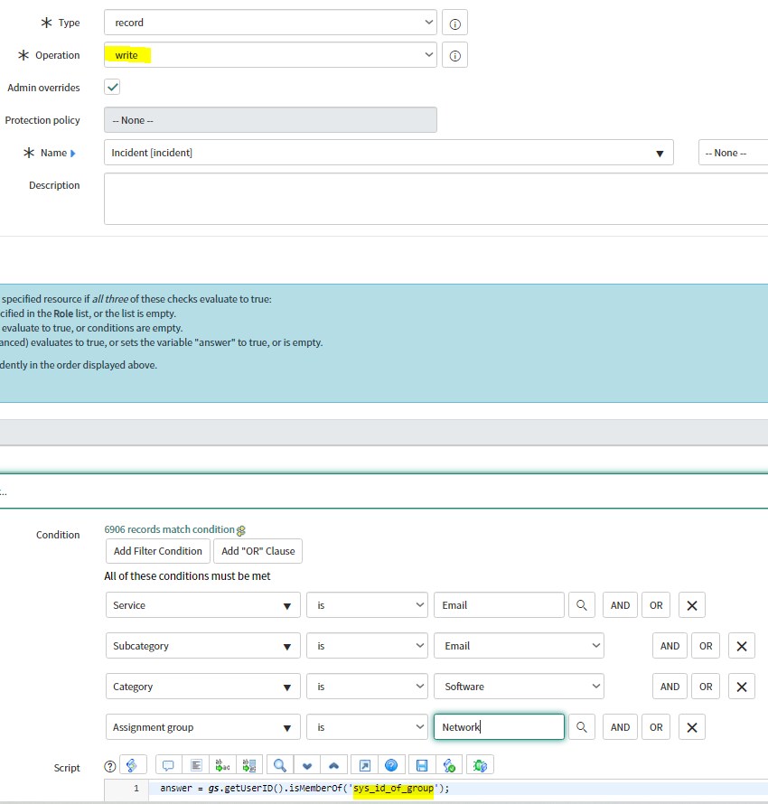

I have a requirement to restrict incidents assigned to group "Network" to only network group members.
I tried this ACL. Can someone tell me what I am doing wrong because when I impersonate someone not in network I can read/ update/ write on the incident etc.

‎06-21-2020 12:34 PM
The issue is with triggering conditions. Please remove all the conditions under when to run.
Also, in the script replace the sys_id with actual sys_id of your assignment group in the 4th line. Currently it contains my group sys_id.

‎06-21-2020 01:20 PM
Updated to correct SYS ID. didn't help.
It should only be read only when category and subcategory is Email so that is why I still need the filters.

‎06-22-2020 04:08 AM
If you look at my first question, this is where I started.
I created an ACL exactly looking like your picture but with READ instead of WRITE and it did not work and I asked for help of finding out why.
I now activated that ACL again but it is still not working.
I tested with a member that is not admin and not member of Network group and it could see the incidents.
