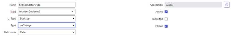

I have below requirement and have to implement via UI policy. But it is working not working when caller change to VIP. However it is working fine for on load.

Hi @Mukul Sharma ,
Please also share a snip of your UI Policy configuration and UI Policy action.

Hi Ander,
Please look into below UI policy and UI policy script.

Hi @Mukul Sharma ,
Sorry the bit of delay to my response 🙂 The reason that the UI Policy doesn't work is, due to you need a server callable script to check the VIP status on the sys_user table. To do this you can create as below (tested in my PDI):
Client script:
Script to be set in client script:
      return;
var user = g_form.getValue('caller_id');
	//call script include
	var ga = new GlideAjax('VIPChecker'); //scriptinclude
	ga.addParam('sysparm_name', 'checkVIP'); //method
	ga.addParam('userId', user); //parameters
	ga.getXMLAnswer(getResponse);
	function getResponse(response){
		var res = JSON.parse(response);
		console.log(res);
		console.log(res.vip);
		var vip = res.vip;
		console.log(vip);
	    if (vip === '1') {
        g_form.setMandatory('assignment_group', true);
    } else {
        g_form.setMandatory('assignment_group', false);
Script include:
Script to be set in script include:
var VIPChecker = Class.create();
VIPChecker.prototype = Object.extendsObject(AbstractAjaxProcessor, {
    checkVIP: function() {
        var userId = this.getParameter('userId');
obj = {};
		var grSysUser = new GlideRecord('sys_user');
		if (grSysUser.get(userId)){
		obj.vip =  grSysUser.getValue('vip');
	gs.addInfoMessage(obj+JSON.stringify(obj));
	return JSON.stringify(obj);
	type: 'VIPChecker'
