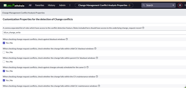

Hi @JanRaphaelC
This is defined in the Change Conflict properties, but the catch is that it applies globally. This means that if you tick or untick the option, the change applies to all types of changes. So, if you're looking to exclude MW or BW only for standard changes, it's not possible.
