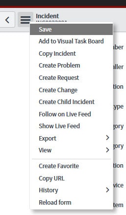

I am trying to figure out if it is possible to convert a request record to a change request either by adding the option to the UI menu on the request record or possibly by using a workflow. I am working with Kingston.
If it is possible to convert a request to a change request, what is the name of the menu in the screen shots?
The 2 shots below show the menu of our requests and incidents. I would like to be able to add the option to create change to the request menu. Any thoughts?

This is already provided OOB with UI action on sc_req_item table to create change request.
Please look into below OOB UI actions for further guidance.

You should definitely be able to convert a sc_req_item to a change_request. The best option would probably be a UI Action on the RITM. I had a similar use case to convert a RITM to an INC in the past. I created an article showing the process to create the UI Action - Convert an RITM to an Incident
This article should give you the basis of what you are looking for, just amend for the change_request table.

Thanks I will take a look at that, Do you know if there is a way to get it to run on the request and not the RITM?
You can create copy of this UI action and run it on sc_request table.
