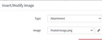

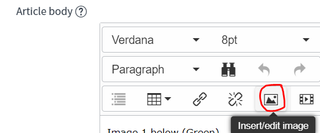

2. Checked out the same article, removed the images I had pasted earlier and inserted from Attachment by clicking on 'Insert/edit image' tool in the html  (Though I deleted the screenshots, the pasted images were still in the attachment table and just selected the same and saved it ).
3. Export to PDF - Exports with images, works perfect.
