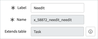

Adding to all above, Access Controls do not stand alone; they are part of list known as an Access Control List (ACL). An ACL is an ordered list of all Access Controls that apply in a particular circumstance.
Recall that the NeedIt table extends the Task table.
Due to inheritance, the Task table Access Controls can potentially grant or deny access to NeedIt table records if no Access Controls specific to the NeedIt table exist. If no Access Control exists on the table, the parent table Access Controls are searched.
When deciding whether to grant or deny access, the ACL is searched from the most specific to the most generic match. For example, when determining whether to grant access to the NeedIt table Short description field, the search order is:
- Match the table and field name: x_58872_needit_needit.short_description
- Match the parent table and field name: task.short_description
- Match any table with the field name: *.short_description
- Match the table and any field (wildcard): x_58872_needit_needit.*
- Match the parent table and any field (wildcard): task.*
- Match any table (wildcard) and any field (wildcard): *.*
