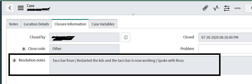

can some one help me how to add resolution notes add into Portal side.

here is Result., thanks Kieran ..!!
