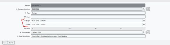

I want to add the Begin and End information from the Outage window to the CHANGE form layout so that an user can see the outage window from the CHANGE ticket itself.
The highlighted information above needs to appear here -
What is the best way I can add those two information as columns in the CHANGE ticket?

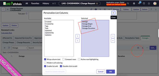

Dr Atul - LNG
Hi @Passion_of_SNOW
Click on the gear icon and select the fields you want to display.
This method will take effect only for the currently logged in user and within the only environment, if you want to do it for all the users and environments (DEV - TEST - PROD ... you name it) then do it via the Configure > Form Layout, Form Designer of Form Builder as suggested by me in a parallel comment

But that will work at the form level — the issue is occurring at the list level. To display the field at the list level, the view I suggested should work.
@Passion_of_SNOW  try below way
Right Click on List Header
Click Configure->List Layout
Add your field to Right side bucket and Save.
glideFather
Hi @Passion_of_SNOW
I used an example of the Outage form, but it is the same for any form - in the left upper corner you will select a table and a particular view and then you can set sections, columns and then drag and drop. This action will impact all the users.
