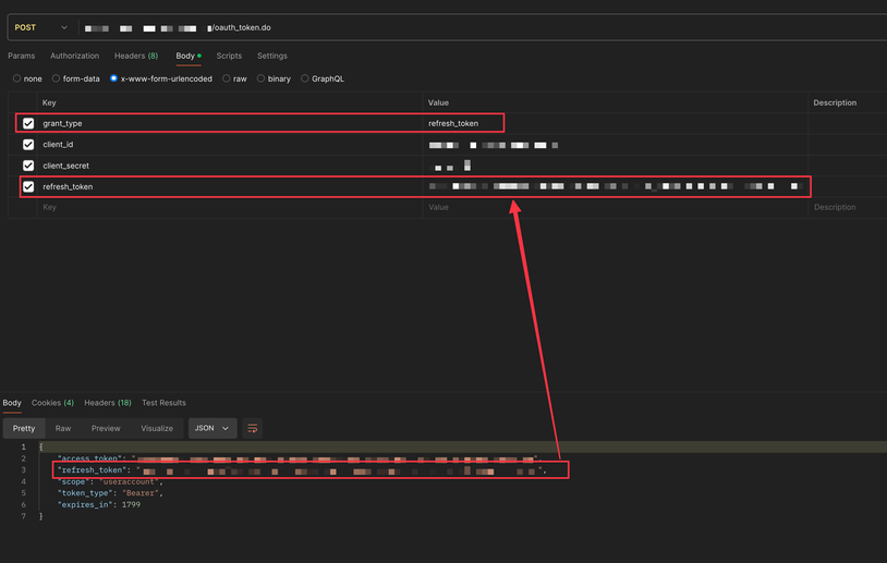

If you're using oAuth, you can make use of the refresh token. Once you've used the user and password combo for the first time, you'll receive an access token and a refresh token. Then, you can use the refresh token to get a new access token.

HI @C_S3,
I assume you've already configured everything in the application registry for OAuth 2.0 and are using the grant_type password to get the refresh token and access token.
Here’s a suggestion: create two system properties to store the username and password. Use the "password2" type for the password property, or you can use the credentials store for both.
Once you've set up the system properties, create a Script Include and call it periodically from a scheduled job to retrieve the token from the provider.
You have two options:
Retrieve and store the refresh token, then use it to get the access token.
Retrieve both the access and refresh tokens every time the scheduled job runs.
Here we are proceeding with the 02nd option
