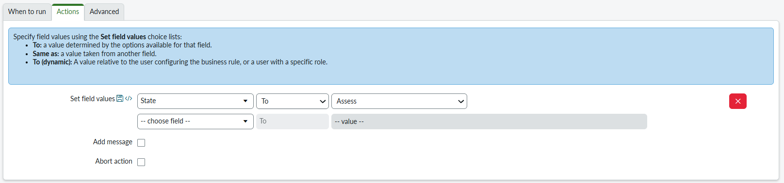

DuyPham
Using a Business Rule is possible, however in this case the condition is not met.
When inserting a record, the After Business Rule is executed before the Assignment Rule.
Assignment Rules run in the Assignment Engine, which is triggered only after the record has been committed to the database.
Therefore, at the time the After Business Rule runs, the assignment_group field does not yet have a value, causing the Business Rule not to execute due to the condition not being satisfied. I tested again with the following configuration, and it works as expected.
