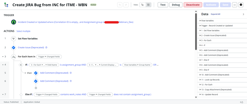

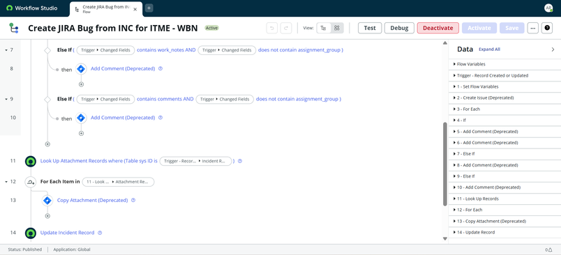

We have ServiceNow-JIRA integration. We have a requirement, to get the payload that gets sent to JIRA from the Flow designer upon any Incident ticket updates? We need it as a JSON format. Is it possible to get it?
Please help.
