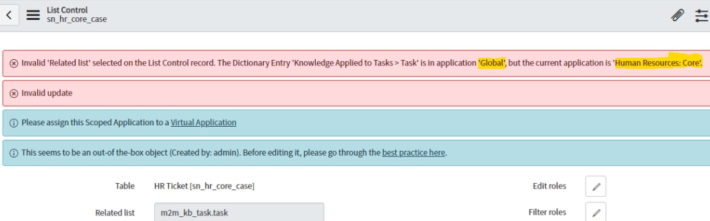

I have few related lists on few Ticketing Modules. .and I want to remove "Edit" button on one of the related list on HR Form, based on some condition. For EX: if the ticket state is transferred, The below related list should not have "Edit" button available.

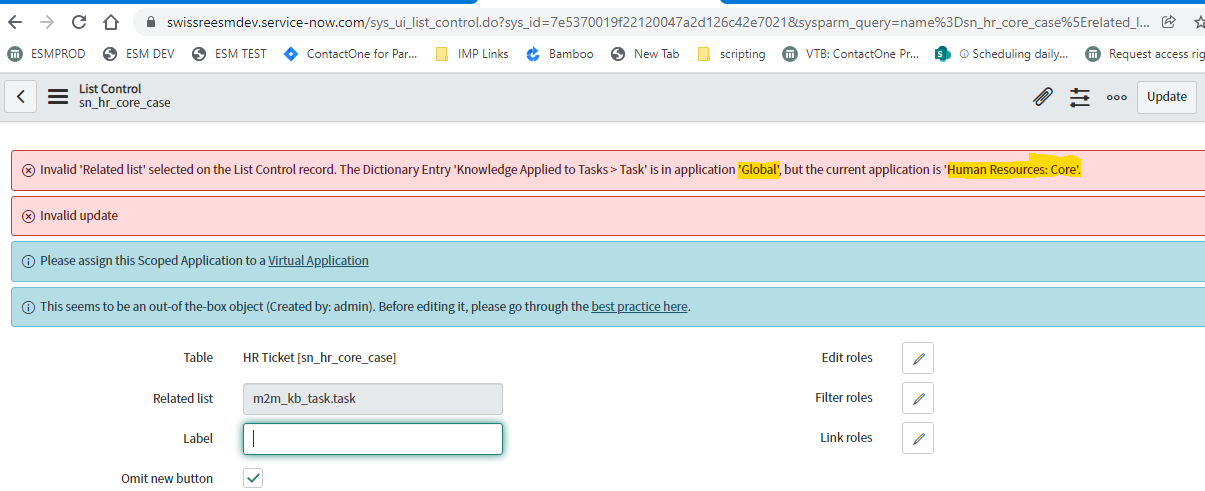

I tried to update the List control record directly by giving the "omit Edit condition" .however due to Application scopes vs Record scope mismatches , I could not save the record with my changes.
Hence , I wanted to remove the "Edit" button using a background script. Can someone please help me how can I write a background script to remove "Edit" button based on the below condition.

I think it would be easier to copy the OOTB UI action "Edit..." and to apply the conditions that you need on it.

If it's not allowing then as mentioned by @Elena Pomana you can try to override the OOB button and update the condition field

But, could not get what I have to really need to do. Are you talking about the below UI action.?. I am not sure, how to edit the scripting part to achieve this requirement. can you please suggest me a simple way if we have any .
change the table name to m2m_kb_task and do insert and Stay
Then update the condition of UI action so that it hides when ticket state is transferred,
