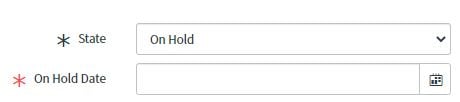

I am trying to create script to automatic set the onhold into 30days how can it be possible on the workflow using toggle script ?

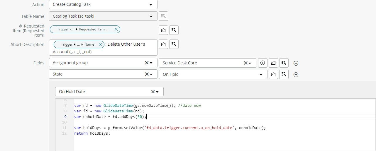

Hello Jeckson,
So you should be able to set this field as per the script provided above. If you field is of Date type then you can use the below script:
var nd= new GlideDateTime(gs.nowDate());
var fd = new GlideDateTime(nd);
fd.addDays(30);
var dueDate = fd.getDate();
return dueDate;
This is what I have used and the due date is getting set on RITM table. do you want to set the on hold date 30 days later based on some other field value?

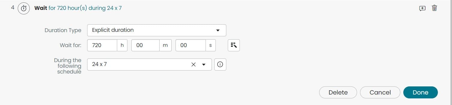

you can use Wait for Duration logic and give 30 days and then update the state
regards

Okay I took it otherwise.
you can use this inline script
var gdt = new GlideDateTime();
gdt.addDaysUTC(30);
return gdt.getDate();
