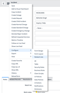

1) Open Incident Form.
2) Click on Context menu/Hamburger. Select Configure --> Related List.
3) Move Below Related List from Left to Right.
