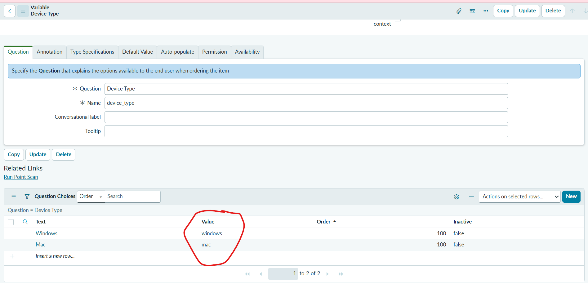

Hello @igsumit007
This isn't an Australia Version issue. The Issue is right there in your screenshots. The Value is empty for both Mac and Windows Question choices. Blank Value collapses the dropdown to a single option.
I reproduced this in my PDI. please refer screenshots
Screenshots 1&2 Replicated your issue
Screenshots 3&4 are the fix for your issue
However, i don't understand one thing, how come your question choice values are empty, when you are creating a question choice, value field is Mandatory. i removed those values using a bg script.
