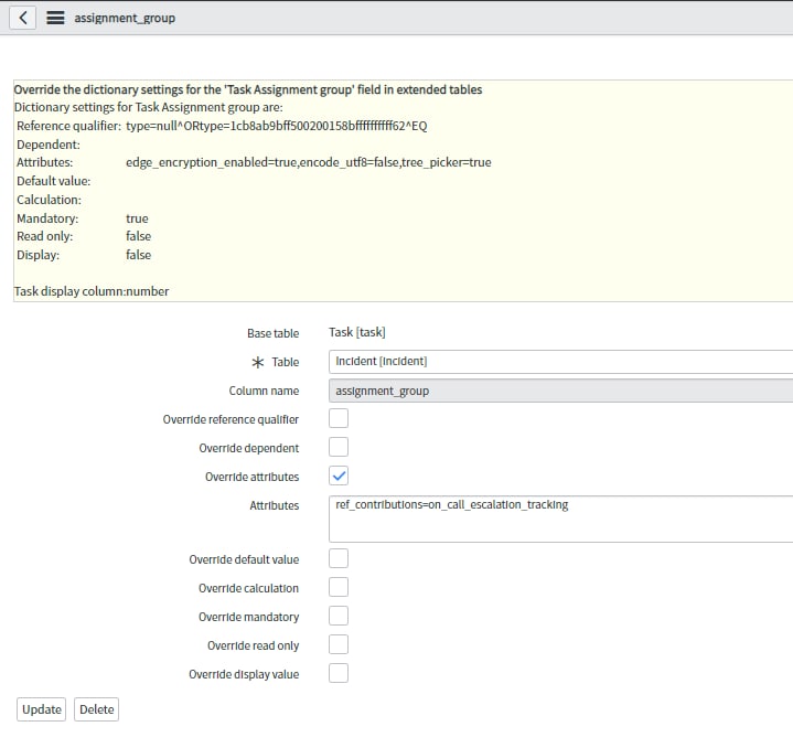

After further trying the steps above, I can get the groups I don't want to show removed from the dropdown, but now it's that way for all viewers.
To explain how I got there:
I created a custom role and assigned it to the (now) 3 groups I need full Assignment Group visibility.
I created a custom group type, went to the groups that will need to see all the list, gave them that "type" in their forms.
Then I went back to the Assignment Group dictionary, and updated the Reference qual conditions to these:
so that if there is no type or if it's not the custom group type, it should show up. So far, so good. Now I'm trying to make it so that those Assignment groups show up for the 3 groups that need to see everything, so I go to the Dictionary Overrides section, and click on incident, since that's the ticket type I'm trying to alter. I put in the following:
From what I've read (and might not have read correctly after a couple times) is if I put in the role that should override the Reference Specification, then anyone/group with that role will see the whole list, and anyone/group without would just see the Assignment Group list minus the 3 I need hidden from them. What I get unfortunately is a full removal of visible groups in the Assignment Group dropdown for any user.
Can you show me what I'm doing wrong here?
