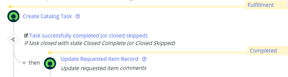

I have a catalog item associated with a flow created in Flow Designer.
Once I request this item, always the stage "Completed" is displayed first (as shown below).
Within the flow, I have a catalog task. Once this task is completed, the stage should change to "Completed".
What do I miss here?
How is possible to display the "Completed" stage as the last one?
Thank you,
Smith.

I believe you can check the order of the flow stage by clicking the three dots on the upper right side of flow designer > then select flow stages, most probably the completed stage is at the top of that order, you can try reordering them by dragging the flow stage through clicking the left hand side (6 dots).

woww this was the trick 🙂 thanks a lot
