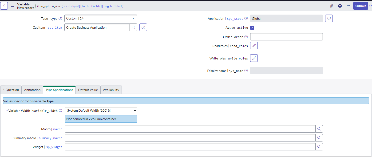

I'm assuming you mean the requirement is to have a button on a particular catalog item which should then take you to the portal.
For this you will need to create a widget and then create a simple button that does this and then create variable in the catalog item of type "Custom" and then add you widget there.
In case you are doing this on the backend, you would need to do Macro, similar logic
