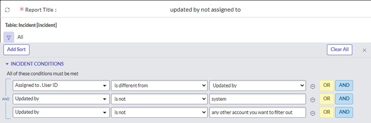

You need 2 tools.  One is the "is different from" operator.  Next, you need to understand that you can't compare assigned to and updated by fields.  Assigned To is a reference.  Updated By is a system generated string.  Thus you need to dotwalk to the Assign To's user_id, which is the only thing that might match Updated By.
When using the "is different from" you MUST express it in the order of Assigned To.User ID - is different from - updated by.  If you start with updated by it will filter out the assigned to column and you can't dotwalk through it.

Uncle Rob
Thank you. I believe that will work. However, I hit another snag. The updated by comes up as the user's email account as opposed to username or ID. I've tried several things like filtering out everything following "@" in the email address. Think it may be something our SN developers may need to weigh in on to complete. I've saved your response as accepted as it did work up to that point. I appreciate your time and help. Thank you.
