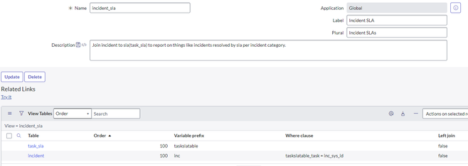

Hi @Bumsefar ,
There is already a solution OOTB called incident_sla
Make a copy of above, and create a new with "left join" set to true on incident to see all incidents no matter if there is SLA attached or not.
If you "just" use the OOTB, then you will only see incidents with SLA attached.
