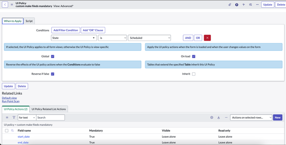

Rutuja Khalate
Hello @Sirisha Snow ,
UI Policy is the efficient way for the above scenario instead of the client script.

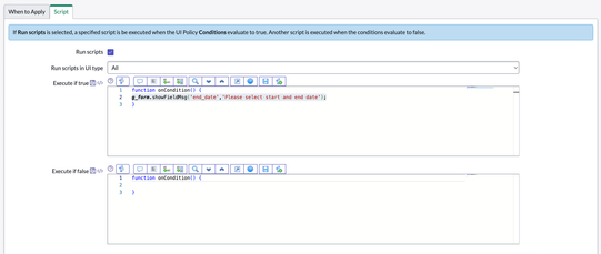

You can create UI policy on the change request table as below and create UI policy actions to make these fields 'Planned start datePlanned end date' mandatory and write one line under script in Execute if true as below
g_form.showFieldMsg('end_date','Please select start and end date');
Also, change the order of custom UI policy as per your requirement to which ui policy should run first.
Please refer below screenshots:
Best Regards,
Rutuja Khalate
Community Alums
 hi @Sirisha Snow
You can use UI Policy instead of client script,
Here are the steps might help you
open change form -> configure -> ui policies
Give below condition and script (if script field is not display go to advance view)
Save the changes -> Go down in ui policy action -> new
add the fields (Planned start date and Planned end date) & make them mandatory
