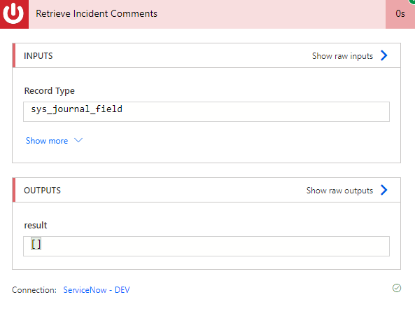

I'm trying to use the Power Automate ServiceNow connector to retrieve the last comments for either an incident or request. Connector is working fine to retrieve task details, it is purely comments that isn't working.
Example of my List Records step to retrieve the entries from the sys_journal_field for the specific task record (using its sysid).
Just returns an empty result:
From my perspective, this should just work so not sure what the issue might be. I did have to add in sys_journal_field as a custom value in the Record Type field.
Would love to know if any one else is able to retrieve ticket comments via the connector in Power Automate.

08-30-2022 02:20 PM
Thansk Ankur. I was using the Order By - connector to sys_journal_field is simply not returning any records/data at all.
