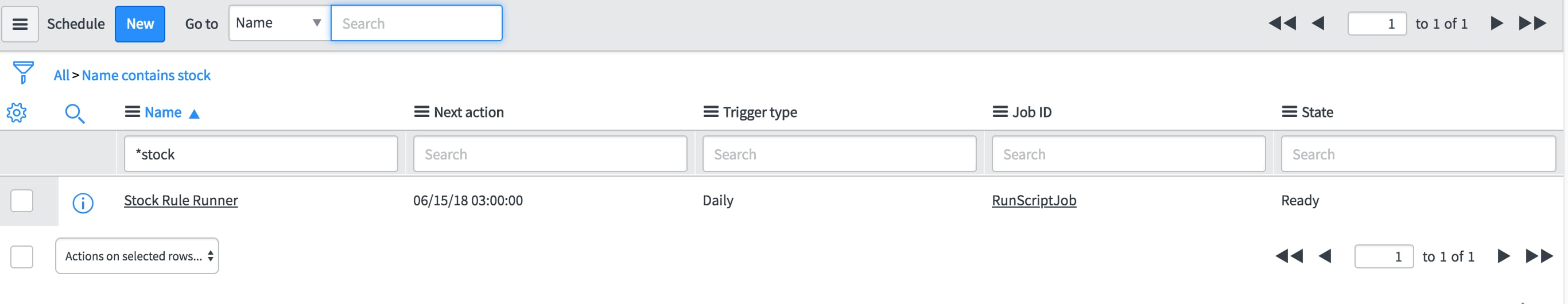

We are on Istanbul. I am setting up stock rules to establish reorder points. I can see the Stock Rule Runner scheduled job but we can find no evidence that it runs. Is there more configuration that needs to be done to have the job run?
10 REPLIES 10
akash_mehta
Dan:  OOB there should be nothing else to configure unless there is something you want to change.
The following is from my instance - you should see a next action, trigger type and the state
Hope that helps.

Hi Akash, I am on Yokohama and this schedule job is totally missing.  I have installed HAM and Procurement plugins. Is this job replaced by some other job? Thanks
@steeple14 mentioned it on a different reply in this thread, but its actually a scheduled item, on the sys_trigger table. Can you access it by the link below?
https://{instance}.service-now.com/nav_to.do?uri=sys_trigger.do?sys_id=073f0b6437112000fceabfc8bcbe5d42
