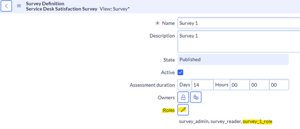

06-14-2023 10:24 PM - edited 06-14-2023 10:28 PM
This is a good answer.
There is an existing read ACL that applies to many of the related/child survey record tables.
Most surveys require a 'survey_admin' or 'survey_reader' role by default to read.
I found that if you reveal the "Roles" field in via form design you can add a new role to read access to a specific survey. This will only apply to that specific survey definition record ('asmt_metric_type') and related tables that have the same ACL rules.
i.e. you can create a new role ("survey_1_role") and associate to the survey definition ("survey_1") and it will only allow users with that role to read assessment tables related to that specific survey.
