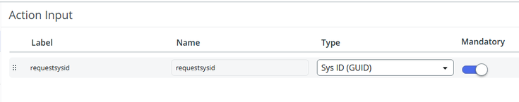

and input as
But in log it is showing as undefined and record is not getting created.

are you passing the RITM SysId properly to that custom flow action?
ensure everything is in lowercase in input variable i.e. Label and Name here -> Give it as requestsysId
then update script as this
var reqSysId = inputs.requestsysId;

Yes i have checked it is correct only but still im getting undefined

if i hardcoded the sysid then it is working fine sla record is getting created seems issue is with the first line alone not sure how to get the sysid
@suuriyas
type should be String
@Ankur Bawiskar ,
Tried that too but still it did not work
in logs im not getting the sysid of ritm it is still showing as undefined
