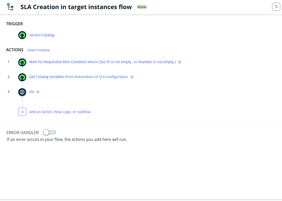

Flow;
trigger condition service catalog

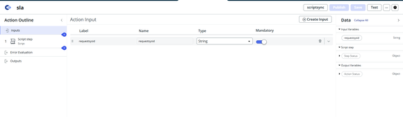

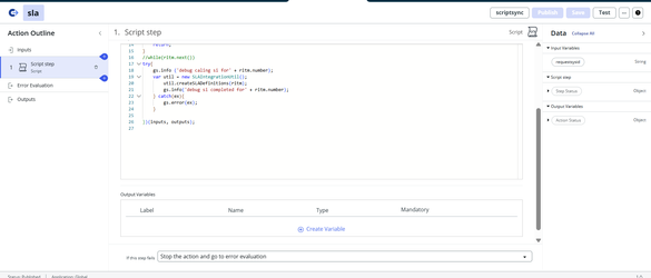

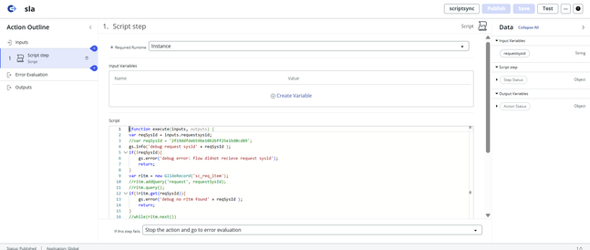

then created one custom action in that script step i have added like this
var reqSysId = inputs.requestSysId;
gs.info('debug request sysid' + reqSysId );
if(!reqSysId){
    gs.error('debug error: flow didnot recieve request sysid');
    return;
var ritm = new GlideRecord('sc_req_item');
//ritm.addQuery('request', requestSysId);
//ritm.query();
if(!ritm.get(reqSysId)){
    gs.error('debug no ritm found' + reqSysId );
    return;
//while(ritm.next())
try{
    gs.info ('debug caling si for' + ritm.number);
    var util = new SLAIntegrationUtil();
        util.createSLADefinitions(ritm);
        gs.info('debug si completed for' + ritm.number);
    } catch(ex){
        gs.error(ex);
})(inputs, outputs);
and input as
But in log it is showing as undefined and record is not getting created.

@Ankur Bawiskar
flow;
suuriyas_0-1764077388740.pngsuuriyas_1-1764077413163.pngsuuriyas_2-1764077439302.pngsuuriyas_3-1764077466524.pngsuuriyas_4-1764077540017.png
@Ankur Bawiskar
I figured it out
i need to map this now it is working fine
